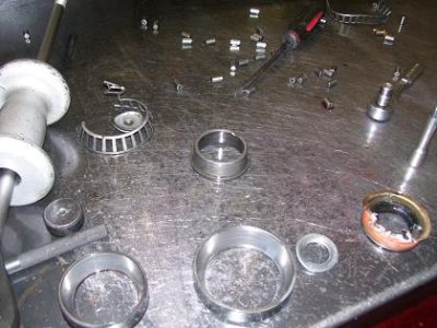

Ok...right at the end of summer I (being lazy) let a friend (whom is a resepected mechanic a LARGE ford dealer) do my ring gear. It is a messy job and I really didnt want to do it in my garage. SOOO...i do him a favor and in turn he does me one. WELL....i think i got the SHORT end of stick.
I originally had 4.30 gears and decided to do a swap with some micronited (sp) 4.30's. When I got in the car the rear end was kinda loud and his reponse was they will be a little whiney cause of the "style" of gears. and "WHO cares it is a RACE car"........OK...clue number ONE...
WELL...present day..I have put on 212 miles since gear change and COULDNT stand the sound. SO i said screw it...Iam going to get messy and do them myself. UH GOD!!!!!!!!! did I find a mess.....
The mesh of ring gear looked fine BUT the bearing looked like he HAMMERED them in. Carrier bearings were DESTROYED..crush bearing had NO pre-load I could spin it free hand. GRANTED, I gave him a master rebuild kit to use also.
here are a few pics of carnage after I pulled it all out..
good thing I never made a pass with the gears set up that way. I am GLAD too...could have been bad news!!!!!!
