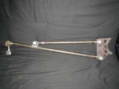

I fabbed this up as a result of not being able to buy a nice TQ arm. the mounting bracket is still a bit rough i haven't had a chance to throw it on the rotary table and whack a nice radious into it yet. But here it is 90% of the way done. Big thanx to Gpowrie on the Design/Fabrication help.
Enjoy.
See other threads pertaining to the TT monster we are building.

I have 3 holes to choose from for my instant center adjustment.

Looks kinda short. What consists of a nice torque arm. 1.27 60ft on a BMR seemed nice to me.
Can you adjust the instant center hieght and location fore and aft on a BMR ?
http://www.bmrfabrication.com/torque arm/trakpak.jpg
That one ??? This one is very easy to adjust hence why its got all the rod ends on it. Not knocking the BMR peice its a proven performer. This TQ arm is roughly the same length but can be lengthened and shortened plus minus 2 inchs for instance center and the Hieght of the IC can be minupuated as well. Personally i have considered that a long held unadressed issue with off the shelf TQ arms.That and this one is all Chromoly.

Never had to.
I am trying to hook up around 1000ft lbs of tq at say 4000rpm with a 6spd and a 3.55 rear gear. I am a little bit traction challenged. I need every bit of adjustment i can get.

Someone is already producing and selling that piece exacly like that except a few more ajustment points that your so called design.. I can't remember who but I'll find it and post a link. A few guys have already bought them but yet to hear any results
I haven't seen one yet. I have heard stories of such a peice. I built this one becuase i could build it exactly as i wanted it to be.Secondly whats the issue with my So Called design ???
Nothing is wrong with it from the looks of it other then maybe lacking a little strength, but there's nothing you can do when wanting that much adjustment. Testing it will be the tell all of everything. Looking forward to hearing how well they work.
