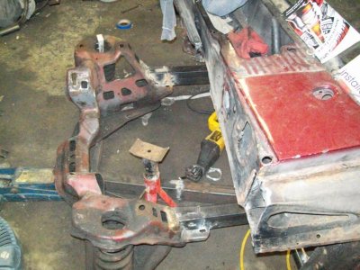

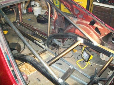

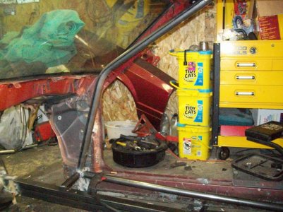

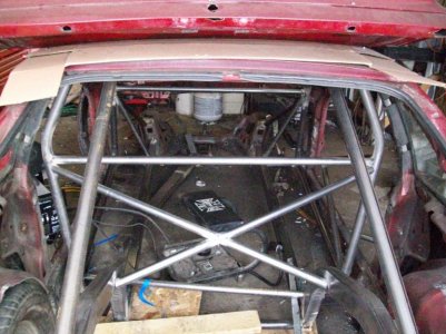

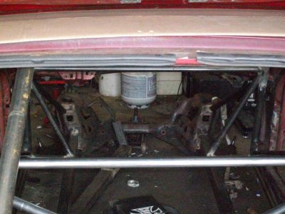

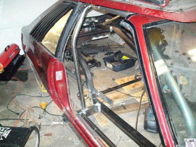

update
been busy doin everything but workin on the car finally have the body attached to the frame and front suspension is almost together for now.Just trying to find some money to get the four link kit for the rear so she'll roll again.pics coming soon
pics
update pics
welds
no they are not stayin was useing a smaller welder, got my big one back and im in the process of redoing should have just waited but I got excited and caused my self more work
