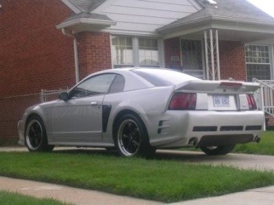

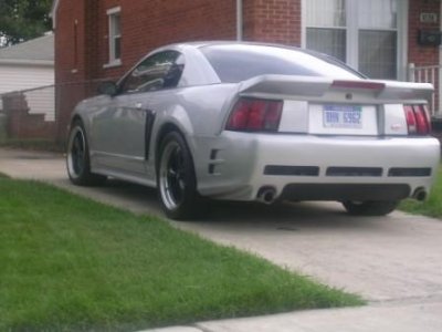

I cant get these damn things even.
Opinions.... drivers side tip higher?, etc.
Put a shim in on how far u want it to be down on both, loosen, snug it, remove shim..
I had it on a hoist. I am going to try it again tomorrow.
And do it then, just like i told you now lol..
What's my name bitch!!! lol
Gettin a little gayish over here...........
No wonder you didnt invite me to hang out with you and Nate.
Grab a pry bar, stick it in the pipe and bend it where you need it.
They do look good, Just move the left one up a bit and over the right and it would be perfect. I don't know what you had on before, When I used to do it at the exhaust shop I worked at we had to heat up the pipe itself and move that because thats what was throwing them off.
Had the same problem with mine. I ended up getting a universal exhaust hanger from AutoZone (it's just a strip of reinforced rubber with holes) and cut it to the right length for both sides. Still not perfect, but good enough.
