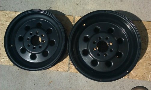

i hear different stuff from different people....no one will really be in the back but my kids so i shouldnt have to worry about rubbing to much, id like to go with a 275/60/15
i think its 4 inch maybe 4.5
im suprised no one has responded
If it's a 4.5 it won't work. The tire will hit the wheel lip. a 5.5 will work all day with some beating and massaging with a 275 60. That's only a 28 10 tire, and guys use them all the time.
ill measure it when i get home tonite, hopefully i have 5.5 backspacing...if its a 4.5 anyone know the biggest slick or radial i can stuff in there??
thanks....its not lowered so i should be goodAnything 26 inch height as long as teh car isn't lowered. If your lowered its gonna rub on just about anything you try to use. if you go 255 you'll have a little more clearance, but it's not gonna look right/best.
they are 5.5 back space....thanks for the help guys i appriciate it
