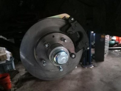

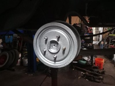

View attachment 85742I also swapped the rear end with one out of a Ford Explorer for a better rear with disc brakes. Just had to move the spring perch’s
I'm using axle from a Cherokee... 3.55 gear drums are fine .. cut the spring perches off my spare axle
I also have the shock absorber relocation kit
what did you use for a master cylinder
