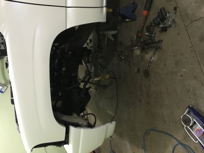

Wish it was that easy. I just had the truck custom painted flat pearl white. Then if I sold it I would have to find a 6 liter to put in a 2wd truck. Only took me a day I have the front suspension out front and rear diff and the trans. It wasn't that big or a deal.image.jpeg
you just need 2wd Hubs rest is the same also witht he diff out pulling oil pan is easier
Yeah I see I need those. But I pulled the torsion bar setup out also so I have to get the lower control arms, springs and the upper spring cups and weld them in.
