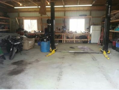

Looking into building a 3500ish sq ft pole barn, just looking for some advice from some guys that have done it on any unexpeted cost or issues I could come across, Or any reccomendations builders or suppliers for pole barn kits. Things I have in consideration currently are,

talk to Oldbutnew. he has heated floors in his and i think he said it keeps his barn warm in winter. mite be better to just run the pipes before you lay cement for use later.
my dad has a 60x80...non insolated, impossible to heat.
make sure you get high ceilings incase u wanna put a lift later.
drains...mite want some.
got a lean-to over hang outside of my dads too, we put the trailers under it or outside equipment.
run water lines, gas lines and cable and phone lines all at the same time with the power lines, even if you dont plan on it, just run it and its there if you decide to later.
put a large service box in to...go over kill. i ran out of room in my box, so i had to tap into my lift breaker for my 220 plug also...i just gotta remember to not use my lift and welder at the same time.
dont know the type of area you looking at, but i decided to put windows in mine....your more vulnerable to a break in, but in the summer time, its nice to open the windows and feel a nice breeze while your working in it.
my dad has two garage doors, one on each end and he gets a nice breeze that way.
i heat my 30x40 with a homemade 55 gal drum woodburner. no insolation at all, and moves the temp up about 30 degrees then it is outside.

Two things before concrete is poured, and I my buddy learned this the hard way, high quality vapor barrier over the ground and also think about some rigid insolation over the vapor barrier as that will help greatly in the floors not getting so cold in the winter.

Translucent panels high up on the wall give you plenty of light without windows.
Don't go cheap on the cement/cement contractor.

What i like about these buildings are the open ceiling which will allow for a hoist on a 10' building
Also when it built it is already firred out so you can insulate it very easily.

2' overhangs. Keeps posts dry, mud off the walls, and no dents from ice sliding off the roof and falling back against the structure.
I'd look into conventional build if you really want to insulate and heat it.
