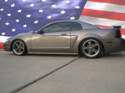

And help on the offset/wheel spacer question about my current wheels? or is it just me?
keep in mind, if you go lower, you cant go wider/lower offset unless you're willing to do some significant fender modding. im sure the ass end of your shit nearly drags on the ground when you put the hammer down. nissan guys are masters of wheel fitment, but they stretch the shit out of tires to make shit fit correctly. if you get good fitment, and meaty tires. you wont be able to drop it any more. it will look fine, but you wont have the rim lip kissing the fender like the nissan guys like.
according to this pic.
you could run probably a 10-15mm spacer up front, and a 20-25mm in the rear. they offset is just too high on those wheels. trust me, im in the same boat. on my 8" wheels, i could be running a -10 offset in the rear of my car. :lol:
Well its going to be lowered a bit more, not tucking tire. If i do so then i cant space the rear out a bit more? the rear just looks to pushed in to me.
because it is. its "sunken in".
