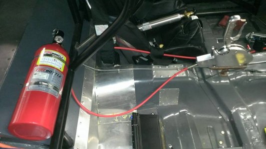

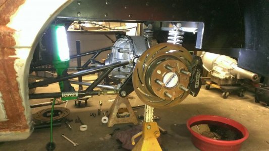

Got the new center section in and the rear end all buttoned up, front brakes put on, water tank mounted and lines plumbed for the cylinder head cooling and the fire system installed.

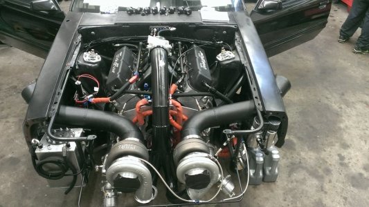

Got converter yesterday, tossed it and the trans in, ran trans lines and mounted up ice box cooler, drive shaft is in etc...

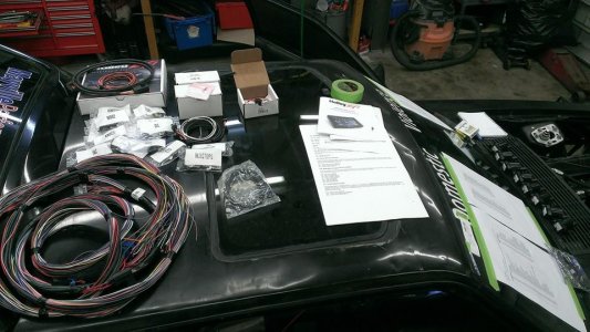

Started wiring it the other day just moving along a little slow at first as the Holley harness sucked so I'm fixing a bunch of it before i put it in the car.
Need to prime the motor, toss in trans fluid and do a once over on everything.

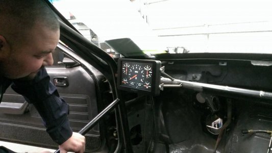

Got the holley dash mounted and working.
