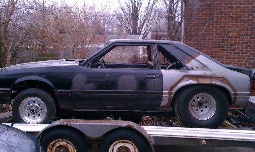

Picked up this car a lil while back from a guy at work.
Its been sitting in a garage for 15 years, he started building it, got married, had kids and the car just sat.

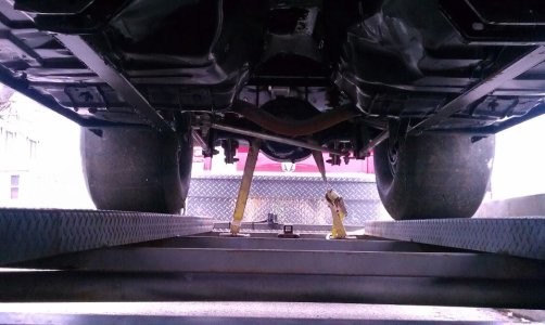

Car as I got it has
2x3 frame rails from firewall back
Full tub's
Tin work done

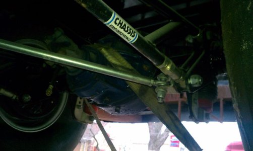

Ladder bars
Narrowed 9"
Stretched/sectioned rear quarters
+2" wheel base
Whole bottom side was sand blasted and epoxy coated
Welds front and rear w/33"x11's under it right now
Cars going to get 25.5
Will be sporting a mild BBF with a glide hopefully it runs as good as the old red one did.

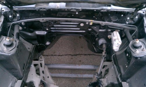

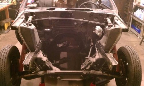

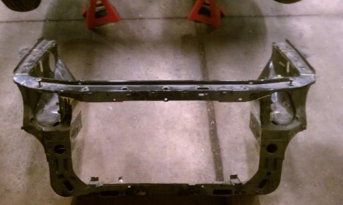

Made a little room the other night to help package the engine. I am really suprised how light the front of these cars are, not at all what I expected it to weight wheni cut it off.
