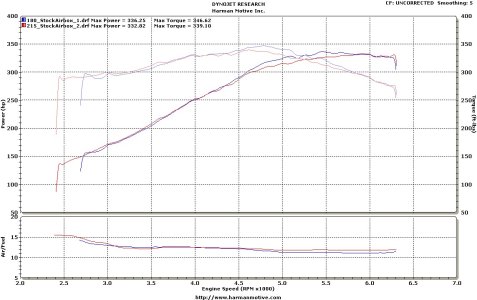

Did they give you a dyno sheet with A/F that you can post? Just curious to see where it was at and compare it to a stock dyno sheet of an SRT-8 which I am sure I can find 1000 of online.

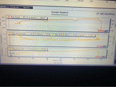

Everyone that has seen this dyno and knows the specs, says this thing should easily be running mid 12's. But I am no where near that at 15.3
Here is a stock 2006 for reference. Not mine.
Man, I wish they would put RPM on the X-axis on that dyno graph instead of MPH. If you look at the boost chart, it doesn't start making boost until 100 mph. Did he go full throttle at 60 mph or kick it down at 100 mph? If he kicked it down at 60, it would mean that your turbos are a restriction from 60-100 mph. Did he pull it through three gears on the dyno? Are those shifts at 90 and 140?

I believe he is manually shifting it through the gears. Your description of the boost kind of makes sense. But I have no way to confirm this really. Main reason I am looking for other inputs and possible another location to go over this thing. Here is the videos of this thing he posted. You can see his shifting.

I was looking over my build list. It shows a boost controller in this thing. I don't remember seeing one anywhere. I may have to look now. between what you said and the possibility that something hit the controller, maybe the boost is jacked up or something.

It says boost controller, do you have a gauge, or anything that shows if it is making boost/pressure in the intake?
Seeing what Geoff stated above, I'd think/hope that they hold it in gear and make the pull, but if it doesn't make any boost until 100mph, it's all pretty useless unless you're running a Supra on the highway from a roll...

No Gauge that I can see. I looked up that controller on the website and it shows a digital readout. So I am going to fine tooth comb my vehicle tonight. And honestly, the build was supposed to make power below 100Mph. That was my goal going into it and this was the system they recommended. I didn't want a S/C as it didn't scale as well for my future plans.
