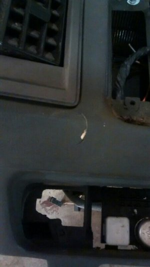

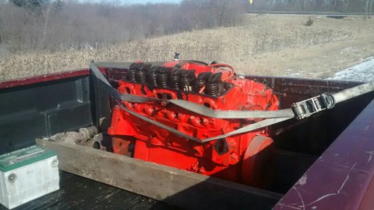

Small update, my dash went to shit, as cautious as I've been to not damage it did no good. Propped the cab up with a 2x4 so I could put casters on the pallet I have the cab sitting on. As I tipped the cab back down the 2x4 fell over and my attempt to kick it out of the way failed, it dropped right on the dash. Was enough to ruin my night... Then I picked up a small block from nitrous Pete. We both ran the casting numbers and thought that it was a 4 bolt main motor. But once I tore into it I found it was a 2 bolt. But it wasn't a big deal since this is a temporary motor anyways. Found its been rebuilt at least once before as the cylinders are already .030 over, rod bearings are .010 over, and the cam is stamped 11-94. Which running those numbers showed just a stock replacement cam. So I'll order a rebuilt kit and still debating on what cam to run.

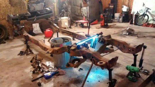

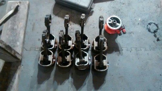

Got 8 empty holes! Which was quite the project in itself. 3 cylinders the pistons had rusted to the walls so bad that I had to soak them for a few days with oil and convince them to move via rubber mallet and BFH. But after a few passes with a hone I believe its a salvageable motor. I haven't had the free time to drop off all the major components to the machine shop yet but we will see what he says when he sees it all. Got all the front suspension torn off except for the lower control arms. So pretty soon the frame will be ready to meet Mr. Sandblaster. Need to straighten the tail of the frame yet but I haven't taken the time to dig up proper measurements to know everything gets pulled to spec. I'm debating on ordering what's left of original body parts in aftermarket since so far I've got: hood, drivers door, both rockers, passenger cab corner, tailgate, one fender (drivers side I think). Since I want a "new" 91 truck when its done I think it would be worth the money to just have every panel brand new and no rust hiding.

Your gonna be real surprised when your searching for another dash. I had a very hard time finding a good condition one with I was shocked thinking."it's just a s10" parts should be easy to get. Lol I'm looking for black/gray dash also if you find one. Along with the rest of the interior to switch from blue.

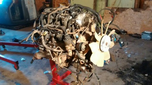

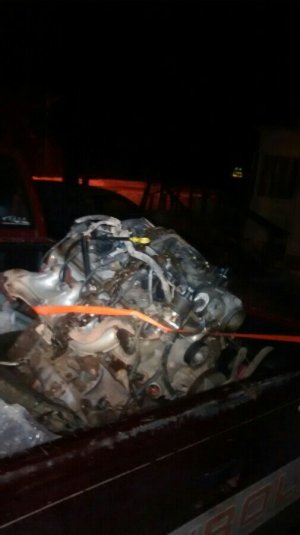

Best day at work ever! Tahoe came in with a "blown motor". So I investigated it a little closer and bought it before anyone knew what was going on. So I got a complete 5.3 with 76k with harness and computer and coils for to cheap to post here. Haha. So now the small block I got from nitrous Pete is going to sit in the back corner of the garage until I piece together enough cheap go fast parts to put it in my z71.

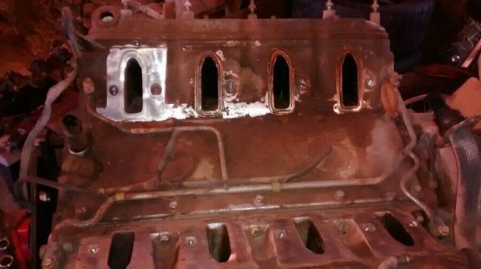

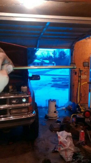

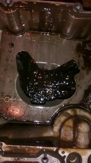

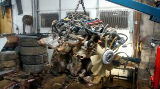

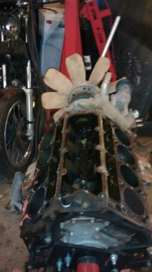

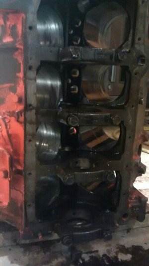

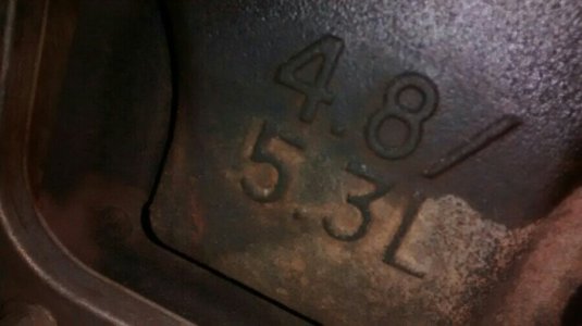

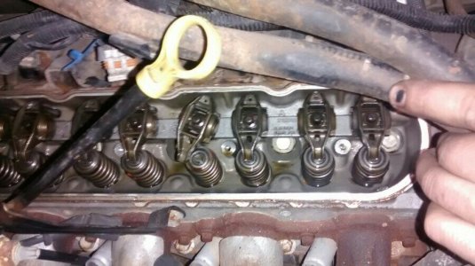

Started tearing into the 5.3 the other day. But I came down sick (again) so progress has been slow. Found that not only did I have a loose rocker on cylinder 4, but also a bent push rod on cylinder 1. And the amount of slug in the oil pan kills me. Granted it's a low mileage motor, but its an ex-police Tahoe so I'm sure it sat idling for hours on end.
