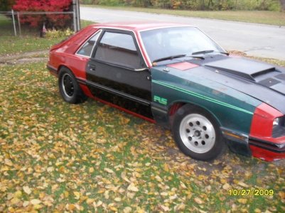

Hey, I'm the guy that bought the Capri with the infamous Pinks motor. This is my first foray into American muscle (I'm actually pretty new to cars, my daily driver is a pretty modified Mazdaspeed 3 that I learned everything on - I didn't know how to change my own oil 3 years ago!)
When i bought it:
Specs:
Motor
Stock Block LS1
Stock Crank
.010 bore
Lunati Pro Mod I beam rods
Mahle Pistons
CNC ported 241 Casting heads
Compression 10.5:1
LS6 Intake
Small Cam (Not sure on the size)
Transmission
Roller Turbo 400 with manual reverse valve body, Trans brake built by Mike Riding (MI) (recently freshened)
Converter (fresh) 4800 stall on spray, 3000 on motor by Mike Riding (MI)
AJE TH400/T56 crossmember
Rear End
8.8 rear end with 3.73 gear
Strange axles
C clip eliminators
Strange spool
Fresh rebuilt posi
Suspension
Double adjustable uppers
Single adjustable lowers
Welded frame ties
Misc.
New red paint job
Twin 255l in tank pumps, rear mount filter and rear mount return style regulator
Battery relocated in the hatch in Morosso Battery Box
So I bought the car several months ago, but have been really busy with life. At first I just wanted to address some small issues like the headers and steering rack - but I ended up replacing a lot. The K-member was rusty and homebrewed, the steering rack was a power rack and it was rusted onto the K-member, and the headers had a few leaks in them... so I changed over to an AJE member, Flaming River Manual rack, and Dynatech headers. The mounts weren't lining up, so I cut up one of the AJE mounts to get it to fit... unfortunately after I did that I found the homebrewed transmission mount was right in the way of the collectors so I swapped to an AJE TH400 crossmember. I still have to get a new set of mounts and hopefully the motor mounts and trans mount will line up correctly. Working on a 5 lug swap with disc brakes now, and I'm probably making this more of a handling road race/autox car than an all out drag car - so I'll probably swap in a T56 when time/money allows. I've never done any of this, so I'm just learning as I go - hopefully I don't fuck anything up too bad! Unfortunately I do not know how to weld *yet* so it's been slow going with getting this all together and getting the exhaust fabbed up. After everything is on, I'll need to take it to C.A.R.S. to get it retuned (currently is tuned for spray I believe). I REALLY hope the motor isn't a bust since the previous 2-3 people that had it didn't really drive it at all. I've been lurking for awhile, seems like a great community!
When i bought it:
Specs: (new stuff in italics)
Motor
Stock Block LS1
Stock Crank
.010 bore
Mahle Pistons
Compression 10.5:1
LS6 Intake
Dynatech headers-1 7/8" w/ 3" collectors
AJE tubular K-member
Hooker Mufflers
Transmission
Rear End
Strange axles
C clip eliminators
Strange spool
Fresh rebuilt posi
Suspension
Welded frame ties
Maximum Motorsports Caster and Camber Plates
Maximum Motorsports Standard offset Tubular A-Arms
Griggs Coilovers coil over 350# springs
Koni Yellow SA struts and rear shocks.
Racecraft SN95 2" Dropped Spindles
Flaming River Manual Steering Rack/Shaft
Brakes:
Aluminum twin piston PBR front calipers with Wagner Semi-metallic brake pads.
11” vented front brake rotors
To install:
Cast iron single piston rear calipers with Wagner Ceramic brake pads.
10.5” solid rear brake rotors
Maximum Motorsports Stainless steel braided brake lines
Wilwood brake proportioning valve
93 Cobra Brake booster and Master Cylinder
Front and rear 5-lug conversion
Wheels:
SVT Cobra 5 spoke wheels 17x9
Goodyear F1 275/40-17
Misc.
New red paint job
To install:
Maximum Motorsports Rear Lower Control Arms
Eaton Brute Force 31-Spline Clutch Type Posi Unit
Tom's Kick Ass 31-Spline Axles with 5-lug hub
Rear disc brake conversion
Trick Flow Rear End Girdle
3.5" H-pipe exhaust with Hooker mufflers
Grey Interior (Maybe dyeing it black)
Ford Motorsport 3 spoke racing wheel
Plans:
Gauges
Clean up the interior a bit, Grey/black interior, rear seat delete
Maybe some cheap stereo stuff.
Torque arm
Panhard bar
T56 transmission
Rust encapsulator the underbody
Capri RS airdam
McLaren Spoiler
Headlight covers
Black moldings?
Tint
So I bought the car several months ago, but have been really busy with life. At first I just wanted to address some small issues like the headers and steering rack - but I ended up replacing a lot. The K-member was rusty and homebrewed, the steering rack was a power rack and it was rusted onto the K-member, and the headers had a few leaks in them... so I changed over to an AJE member, Flaming River Manual rack, and Dynatech headers. The mounts weren't lining up, so I cut up one of the AJE mounts to get it to fit... unfortunately after I did that I found the homebrewed transmission mount was right in the way of the collectors so I swapped to an AJE TH400 crossmember. I still have to get a new set of mounts and hopefully the motor mounts and trans mount will line up correctly. Working on a 5 lug swap with disc brakes now, and I'm probably making this more of a handling road race/autox car than an all out drag car - so I'll probably swap in a T56 when time/money allows. I've never done any of this, so I'm just learning as I go - hopefully I don't fuck anything up too bad! Unfortunately I do not know how to weld *yet* so it's been slow going with getting this all together and getting the exhaust fabbed up. After everything is on, I'll need to take it to C.A.R.S. to get it retuned (currently has a NOS tune I believe). I REALLY hope the motor isn't a bust since the previous 2-3 people that had it didn't really drive it at all. I've been lurking for awhile, seems like a great community!

this is the old stuff i took out of the car - can i sell the headers/k-member for anything? send me offers if you want anything!
i'll be taking out the wolfe double adjustable uppers and single adjustable lowers too if anyone wants dibs on those.
flowmasters

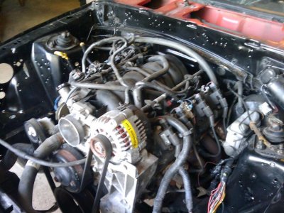

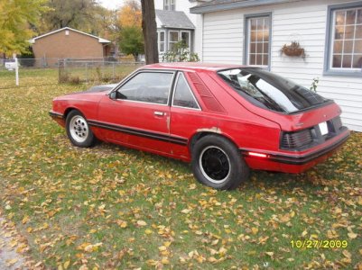

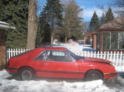

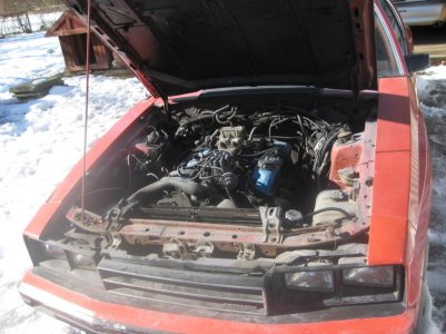

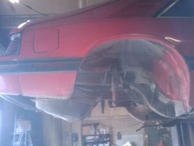

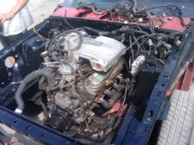

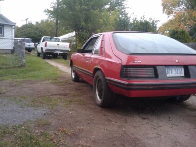

i compiled all the pics i could find on here from when 91trunks, mikefastss, jameser owned the car to have a picture history of the car from when it got pulled out of a barn until now: Capri History
some work got done, front fenders rolled (can't do the rears yet because it's still 4 lug and the fender roller doesn't fit), i got the back seat out, and the old wolfe racecraft rear lca's were taken out.

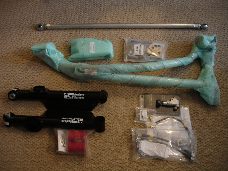

Maximum Motorsports Camber plates
Racecraft 2" dropped Spindles
Koni Yellows with Griggs coilover kit 350lb springs
SN95 Hub, 11" Rotors, PBR 2 piston Brakes
Maximum Motorsports Std. Offset A-arms
AJE K-member
Flaming River Manual Rack
MM Panhard bar, Brake Lines, LCAs, etc.

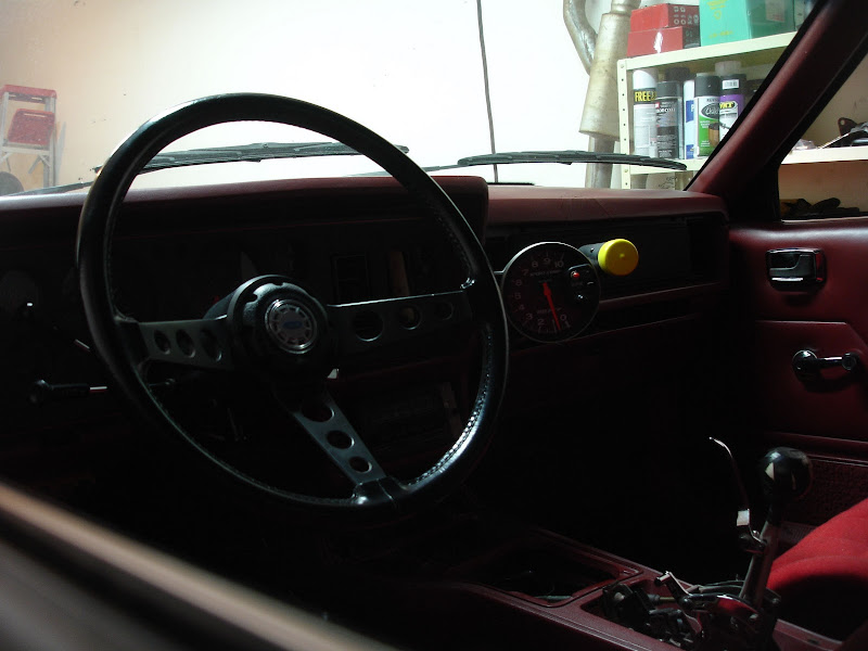

Ford Motorsport 3 spoke wheel

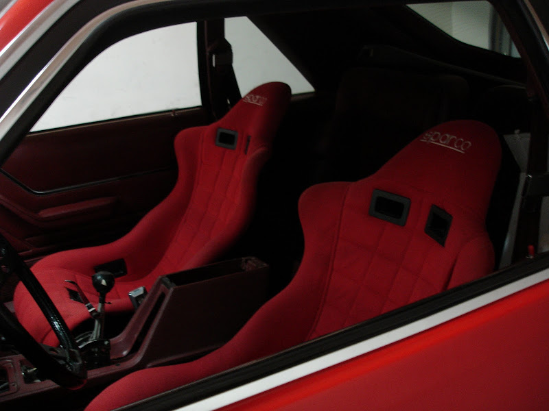

Sparco CF seats from a Ferrari GTO. They'll look better with a black interior
Awesome! Please, please keep this car. I wanted it when it was for sale a few times, but bought a house so I couldn't have money tied up with toys. Really looking forward to seeing it on the road.
thanks! i think i'm pretty invested in it, so i'll probably won't be letting it go anytime soon. unfortunately it'll be pretty slow coming together due to my limited wrenching experience and having to wait for friends that can weld. i'm definitely learning a lot along the way though! i need to get the new subframe connectors in before i can install a lot of the other parts, so i'm waiting on someone to help me weld them in.
