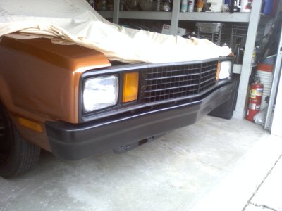

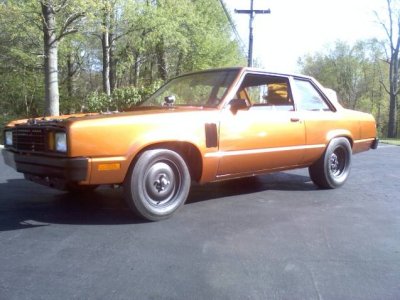

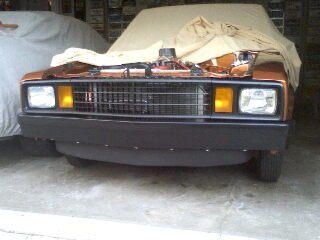

Got the front bumper painted and mounted finally. I did sink it in a couple inches like the rear bumper. Looks alot better that way.
Tucking the bumpers in makes such a huge difference in these cars. Looks killer!
