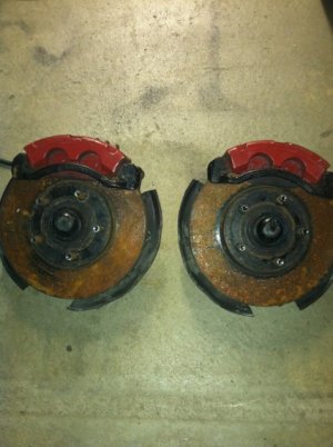

I have an 87 lx 4cy base. i want to convert the front to 5 lug for better wheel selection. i have the 5 lug 11" rotors already but from what i read those will not work with my spindles. so back to square one!
its my street/drag car. Im mainly looking for 94+ spindles, rotors calipers and lines. But if i can get a set of v8 spindles for my rotors and calipers thats good aswell
If you want to use the 4 cylinder spindles you can get a set of 83-88 ranger 4 cylinder rotors. You will have to change the races but they can be use from the mustang rotors.
