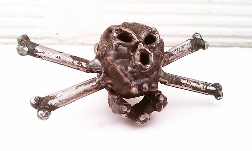

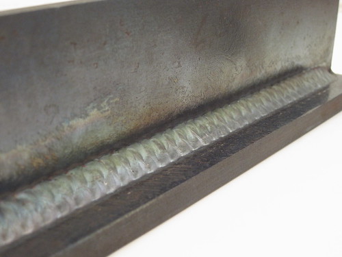

some random welds I've messed around with recently(these 1st 2 look cool viewed big, check them out here):
http://www.flickr.com/photos/browndogwelding/5170390430/sizes/l/in/photostream/
http://www.flickr.com/photos/browndogwelding/5167287957/sizes/l/in/photostream/
<a href="http://www.flickr.com/photos/browndogwelding/5169533701/" title="Ever seen an Iron Cross like this? by Brown Dog Welding, on Flickr"><img src="http://farm2.static.flickr.com/1241/5169533701_524c6795f2.jpg" width="374" height="500" alt="Ever seen an Iron Cross like this?" /></a>
<a href="http://www.flickr.com/photos/browndogwelding/5145067675/" title="No catchy tag, just tig welds. by Brown Dog Welding, on Flickr"><img src="http://farm2.static.flickr.com/1233/5145067675_33e3b8bd8f.jpg" width="500" height="299" alt="No catchy tag, just tig welds." /></a>

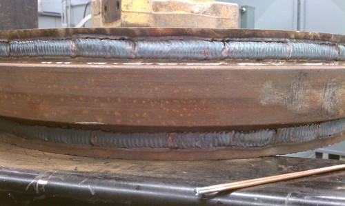

Here I did some build up on a bulldozer wheel. It was worn in the middle on both sides where the track rides. I took two 1/8" rods, put them together, and did a weave with the tig torch.

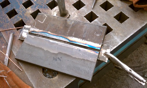

some aluminum

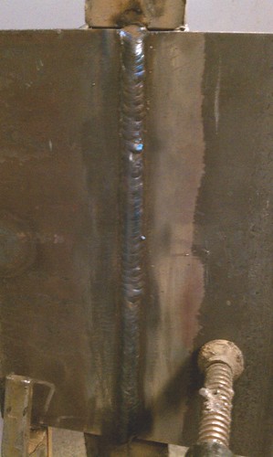

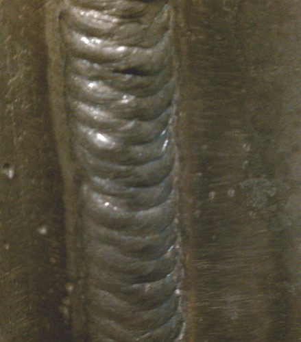

No pics of that, but I when I found out they passed I decided to do the same plate with stick. I used this bad ass old Lincoln SA400
It's so freaking smooth. I did a 1" thick plate with a K joint using 5/32" 8018 electrodes. It's hard to see in the pic, but the root pass came through the back side really nicely. I need to get a bigger shop so I can start collecting some of these machines :D
The back of the root:
front finished
back finished
