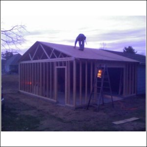

Im building this right now that is going to be my new booth. Currently I still have my setup in my dads garage wich just consisted of a 12x20 enclosed room with not enough lighting and too small an exhaust fan lol, Not ideal but has worked awesome for me for the last 5 years. What I've been told is best is to have enough cfm in your fans to fully exhaust all the air in your space in 1 minute or less. For inlet I just have filters open to the outside of the room. Not sure what im going to do in the new garage but like smooth said I will for sure be putting an epoxy on the floor.
