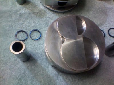

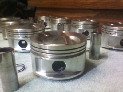

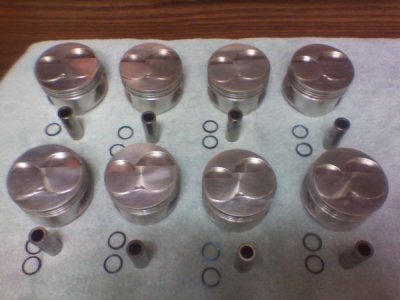

These are my sons, Very good shape, Give him a call/text and make him a offer, Tell him you are from MM

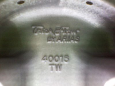

Part Number: TFS-51404000
Bore (in): 4.030 in.
Piston Style: Flat top, with two valve reliefs
Piston Material: Forged aluminum
Compression Distance (in): 1.600 in.
Piston Head Volume (cc): +2.00cc
Wrist Pin Style: Press-fit or floating
Pin Diameter (in): 0.912 in.
Piston Ring Thickness: 1/16 in. x 1/16 in. x 3/16 in.
Notes: Specifically designed for the valve angles of the TFS Twisted Wedge heads.
Like New Only has 40 street miles on them
Asking $350 Call or Text Scott 810-937-7340 Anytime
Thanks Scott! Now we're getting somewhere. Damn near everything fits what I'm looking for aside from being for the TW heads and it appears in the pics that even though they are a FT they still have a raised surface.
