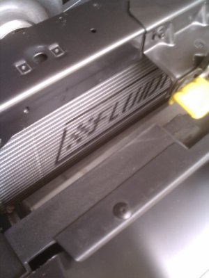

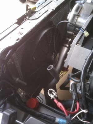

gave a pic of 16" fan on my radiator and place where the push fans will be mounted on outside of radiator
