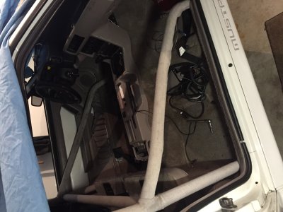

Here is the beginning of the interior/dash cleanup
Heat is out. Now on to the wiring......this is going to be a big project....its a rat nest under there.....and I'm to blame. I've owned this car since 98......so its all my doing.
I have to address the holes in the firewall now. I think I may just do the scottrod panel for now.....maybe next winter I can pull the motor and address the entire engine compartment.

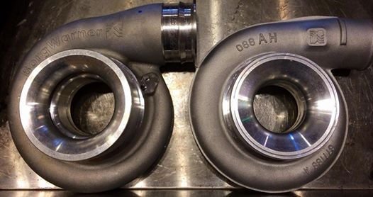

New Turbo

The new turbo cover came in.....
