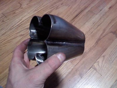

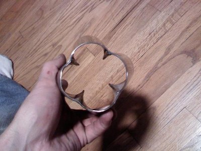

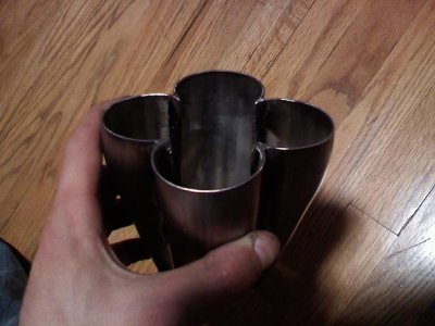

is there a market for these? the only other company that i see does them is spd and they are way over priced...just made a couple sets for some headers im doing...this example is 2" stainless...1 7/8" primaries fit perfect...lemme know what you think...they are welded inside and out, and merge to a 3" pipe...15 degree transition

Cone engineering makes merge collector kits. Not as nice as those though but press formed and very inexspensive.
yeah...i can do these for between 150 and 165 ea, this is like in between slip merge and formed for the guys that want the mandrel bend instead of staight transitions...
