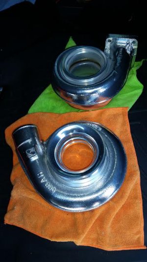

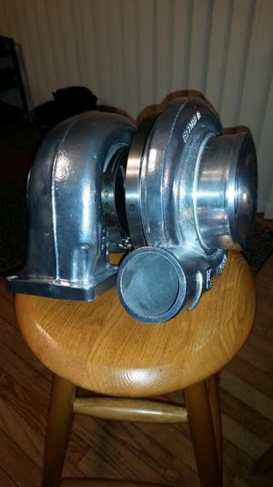

We decided to go with a twin turbo setup vs the big single. This will make the car alittle more street friendly, quicker into boost and all that fun stuff. Still stuck with the borg warner Airwerks series. In doing this i also decided to ditch the aluminum block. I really didnt wanna get this all done, have all this capability, and be limited by the block. So i turned to a 6.0 iron block. So that should do the trick. Turbo400 tranny is being rebuilt and stepped up a bit. Here are a few quick pics. Mr. Powrie is on a roll.
Turbo machined down to accept a vibrant v band assembly.

Twins
