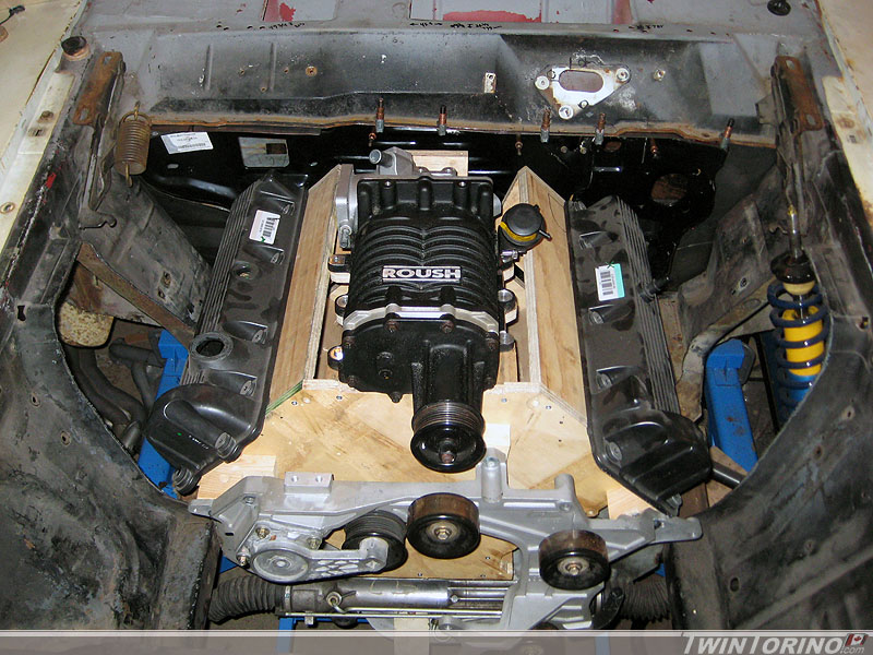

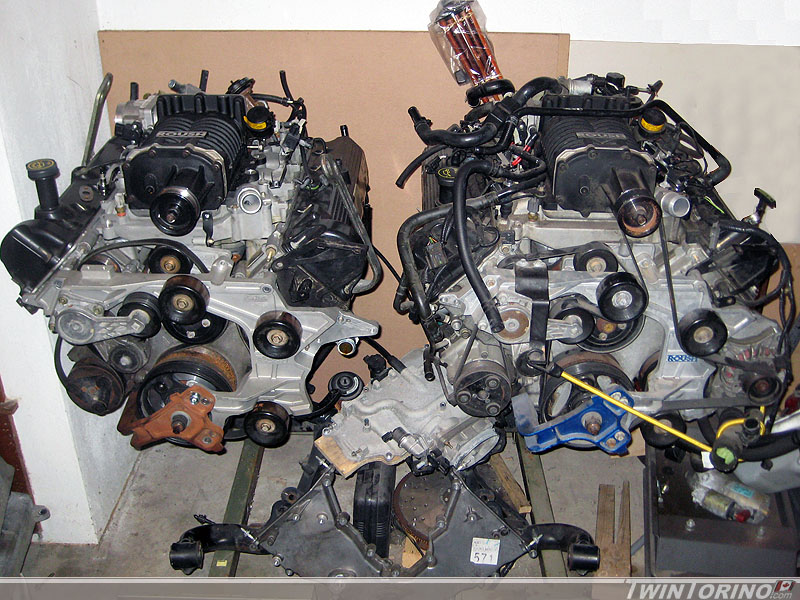

We have recently changed our powerplant plans to use a 4.6L 2V Roush Stage III. It barely fits with stock hood clearance which was a necessity since we dont want to change the appearance of the stock hood.

2V vs 4V
We came across the 2nd motor recently for a good price, we couldnt pass it up. We thought it was pretty unlikely to come across two of these motors, so it seemed like a natural application. The supercharger will give us alot more power for the buck; When we started to add up the cost of what it would take to get the 4V up to +400hp, we opted out in favor of the 2V. The supercharger just barely fits under the hood.
It's been a while since the last post, but here is the car currently.
The SN95 front suspension is in, the rear IRS is mounted, and the motor and transmission have been slung into position. Alot of hard work to get to this point, we should be close to firing at the end of summer, stay tuned.
