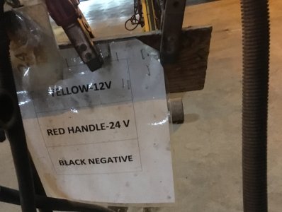

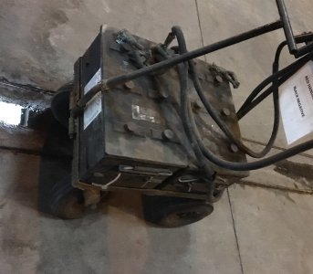

Ill take a picture of the jump cart we have at the bus garage its wired 12 volt and 24
