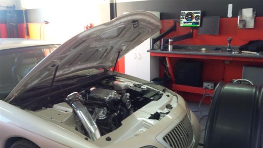

If Lidio could tune one of my 2.6H KB Lincolns w/auto for perfect driveability at almost 600rwhp, then I am sure he can handle a mustang ;)
