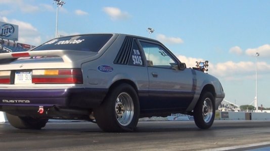

I very well be mistaken but I had always thought I was running a 4.5 BS Weld. I know they are 8" at least. This is with 275/50 15s. My fender lips were rolled for my street tires so these have no issue rubbing.
That looks like that tire is working great for you! I can see the wrinkle. :) What kind of 60's do you get? Very nice!

Not quite as good as it could be as I'm still learning how to make it work on them, but they are stinking BFG Drag Radials. I've been 1.59 a few times on these but for the most part it's very low 1.6's. They aren't quite as easy to hook as the MT DR's.
