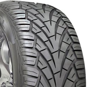

I daily drive a 2wd 07 TBSS and this will be its 5th Michigan winter. I was in the same boat last year at this time and after allot of research and testimonials on the SS forums I ended up scrapping the stock Goodyear’s for a set of General Grabber UHP's (275/45/20). The summer/winter-traction/handling is much improved over the Goodyear’s and for the price, I would buy another set.
