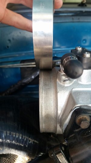

Does anyone make a thin t-bolt clamp? I keep popping off the TB hose with my BBK throttle body, because there isn't enough lip area to hold the t bolt clamp. As soon as I get it nice and tight, the pressure pushes it off. I had a worm clamp on there before which held, but after I removed and reinstalled, it's no longer holding.
Here's what I'm dealing with...
boost? I have always sprayed the silicone hose with cheap dollar store hairspray. they stick like snot in a screen door
tried the hairspray, along with a high torque worm clamp from NAPA, but no time to drive it today. I'll give it a try on Saturday.
