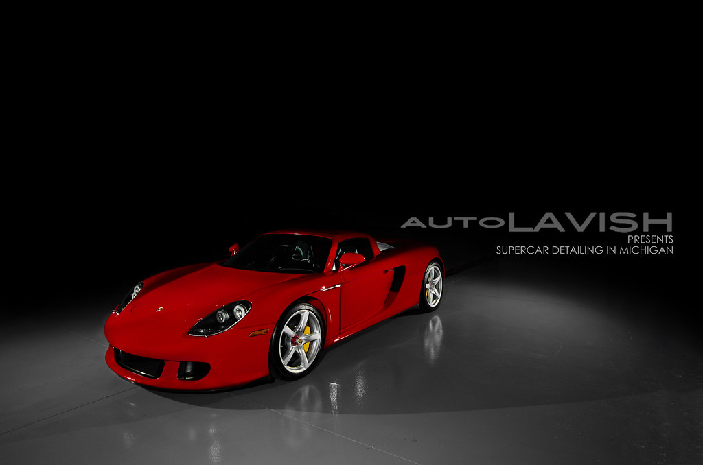

With the weight of a VW GTI but more than 3 times the power, the Porsche Carrera GT is the essence of what a supercar is: a street legal race car. This isn't your run of the mill exotic that is equipped with a few go-fast goodies and a few pieces of trim made from lighter weight material.

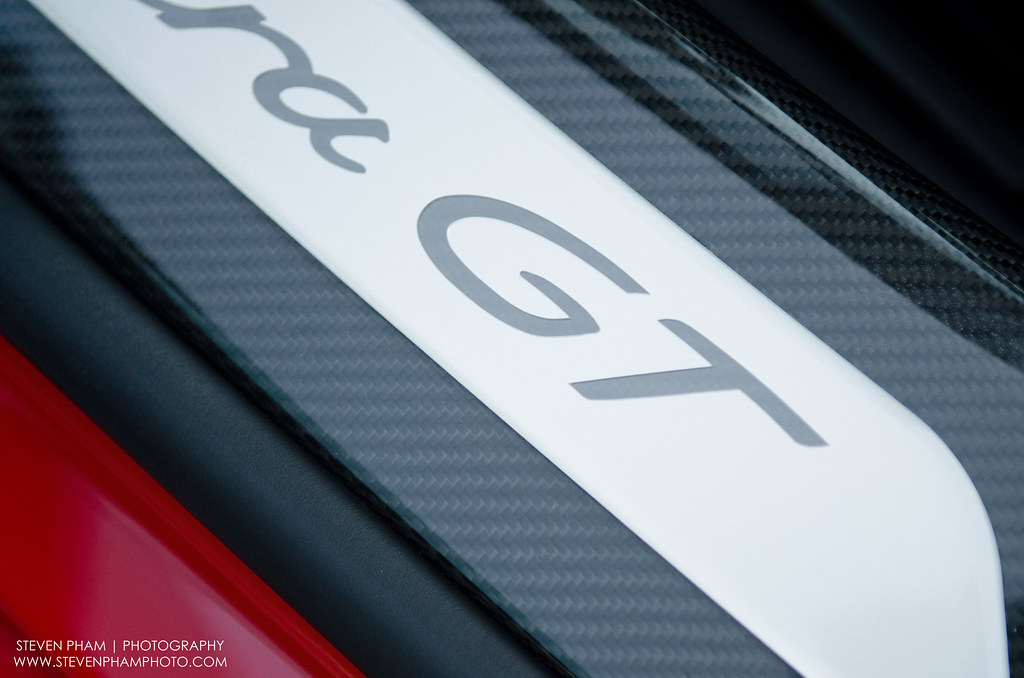

The entire vehicle is carbon fiber.
