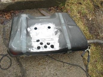

Those pickups are pretty good size from what I've seen and the swiss cheese method should keep the fuel from sloshing around corners and braking.. Are you running a carb?
That's a third gen camaro tank in the pic.. I think the guy used a comp engineering sump. Must bee friggen massive cuz those tanks are like 14 gallons.
