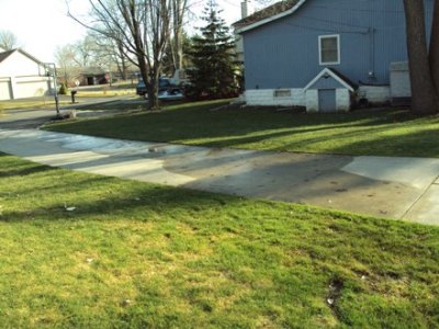

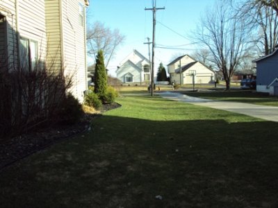

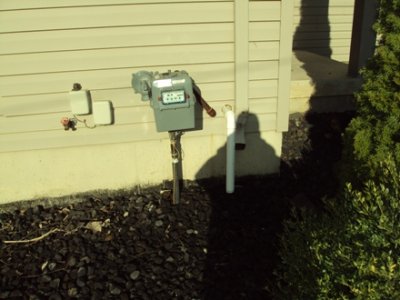

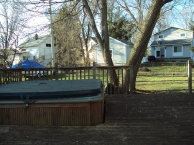

Ok so I have been in the is house for 1 week now and my neighbor has bitched to me twice about my sump pump pumping so much water that it is draining across his driveway and going down his grass too.... Now I really don't know a lot about sump pumps, but I do know that if it isn't pumping water out then my basement will flood....right? I think it is pumping a lot of water cause we had a pretty fast thaw this winter and also the houses behind me are on higher ground....so my question is, is there anyone here that knows sump pumps that can tell me about them or possibly come over and take a look at mine and tell me if this is right? If it is right and normal what should I do, cause this guy is starting to piss me off, and I don't know what I can do to keep the water off his driveway

Yes the pump sounds like it is working fine. It is emptying the sump in your basement (this is a good thing).
As for your neighbor, about all you can do is route the water to another location. You can do it with PVC pipe or any other means necessary. Just make sure you route the water so it continues to drain AWAY from the house not back towards it, or else the water will just find its way back into your sump.

Sounds like the sump is working properly, and your getting the run off from the houses behind you. Whats out in front of you house, a ditch or storm drains?
All above is right. Where is it draining? Where has it been training all these years? Where to your neighbors drain? It should be draining underground to a sewer. Is it just exposed pipe outside your house? Did it throw any home inspection flags or concerns? He knows you just moved it....buy him some water boots and a dildo. If he doesn't appreciate the boots he can go FUCK himself ;)

Technically you could install a field which is just perforated PVC laying on pea gravel under the surface. This is such overkill for a sump pump drain though and would be even crazier because the neighbors driveway is "wet"

re-route it somewhere no one will care about, or make a small pea gravel field below the ground away from the house, not hard.
to answer most questions...he told me that the pump has never pumped this much water in the past 7years(first time bitching) then the second time he said 10 years...well the house was built in 1994....I honestly think he was bitching to the original owner and the original owner probably said fuck you deal with it.....
also he doesn't have a sump pump, his house is a bi/tri leval...also my basement ceiling is 8ft.
the basement has absolutely no signs of ever having water damage(1 of many reasons for buying it), the home inspection had no flags on anything involving the sump.
question on routing the pipe somewhere else....would I have to bury the pipe below the frost line so the water that stays in the pipe wont freeze?

I will look into that, but my concern is IF I re-route the line wouldn't I have to go below frost line so the PVC pipe wont freeze and crack?...if that's the case I will buy the neighbor a brand new shovel and he can help me dig, cause it is at least 40+ft. from where the pipe comes out of my house to the end of my driveway.
