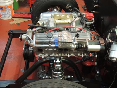

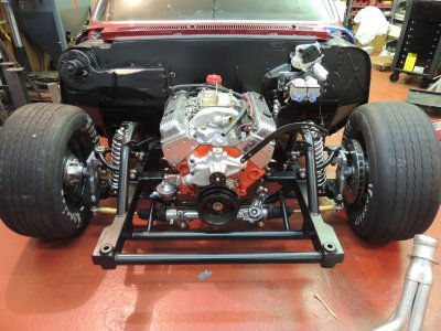

Probably a stupid question, but after the engine and all front end weight is there, will the steering rack be sitting on the ground?
Getting Closer....Won't have quite the HP Huggers has, but it'll give his car a run for the money.........
The intake, carb and valve covers were from my 72 Z/28......

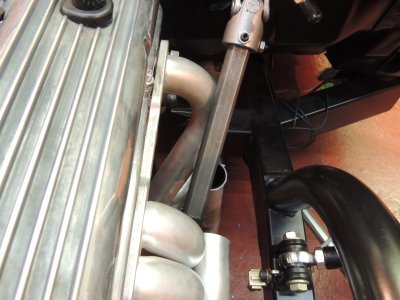

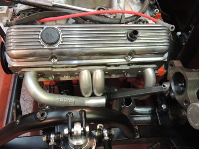

Now all I have to do is find someone who can repair my headers and modify my existing stainless system to fit this chassis...It doesn't hit as bad as I thought it would...
Any suggestions or recommendations? (Near Troy)
