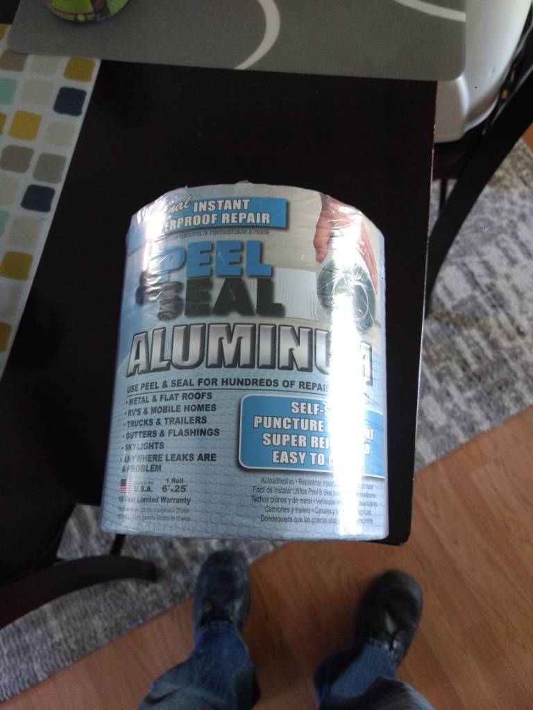

Found an article from Roadkill when searching alternatives to Dynamat. This will was $16 at Lowe's. 6"x25'. It's apparently close to Dynamats original product but much cheaper.

I used this my 66 C10 I was real happy with it.
