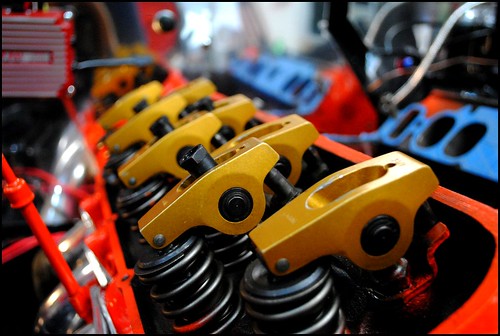

Crane 1.7 Roller Rockers

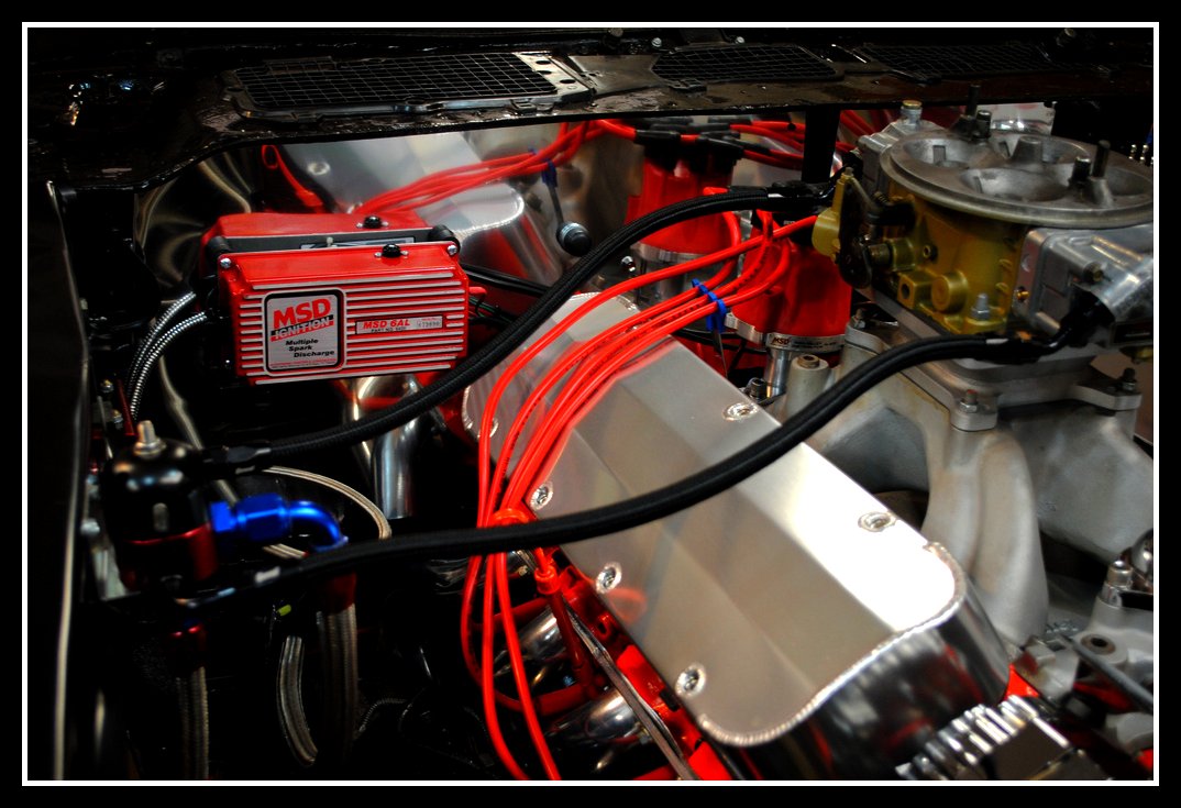

Holley 4500 style Dominator carb

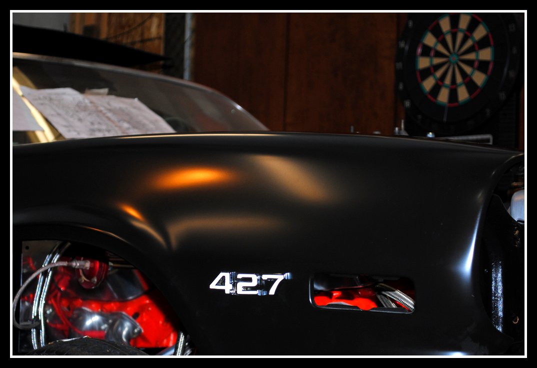

And in case you wondered what the whole thing looked like

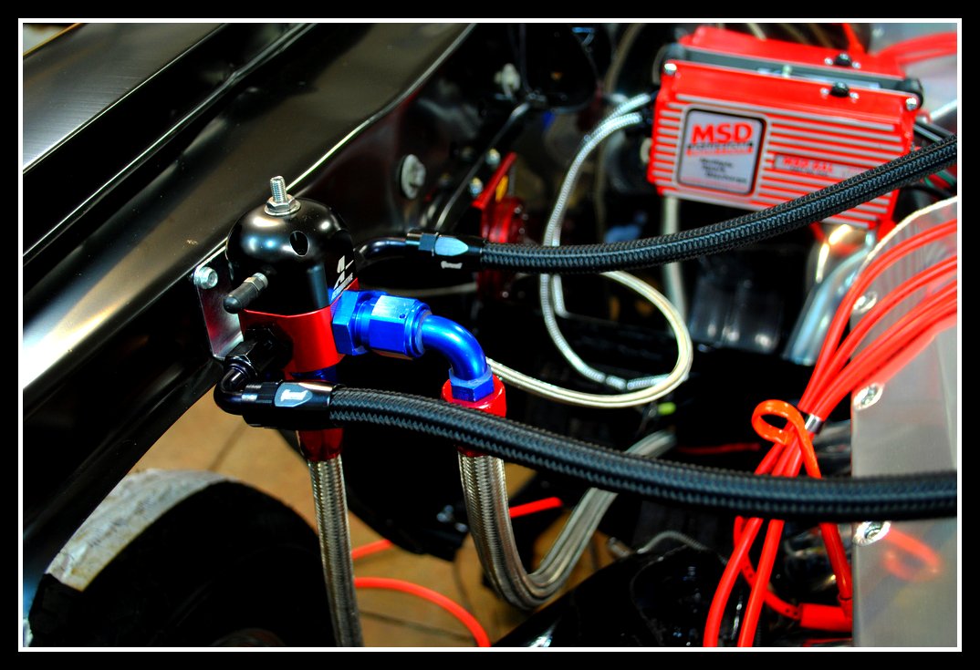

Got a little progress today. Went up north to NPD and picked up a set of new fenders, and a TH400 crossmember. Got the fenders on, started to plumb the fuel system. Got the Aeromotive regulator mounted, and started running the lines. Also mounted the radiator, trans-cooler, and electric fan.
Fuel system consists of:
12 gallon fuel cell
Aeromotive A1000 fuel pump
Aeromotive 100 and 10 mircon filters
-10 feed line
Aeromotive bypass regulator
-8 return line
-6 feed from regulator to carb
-4 to FP
Well, I'm about ready to put this thing back in the corner and cover it up, where it's sat for years.
