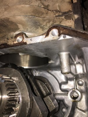

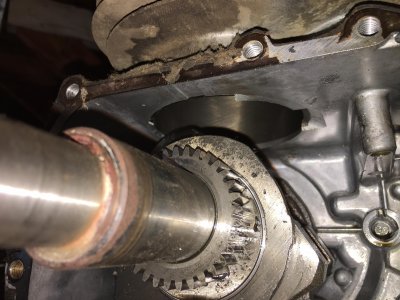

I have an older 12hp flathead briggs and the connecting rod broke. I removed the remains of the old rod and piston from the block and left the crankshaft in. The cylinder walls don't appear to be damanged, maybe a really small scuff in one area. However, inside of the the crankcase just before entering the cylinder wall there appears to be an area with some bent and missing metal. I am trying to figure out if I can just buy a new piston assembly and go back to running the engine or if this damage is a larger issue than it looks...
