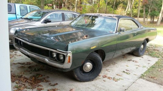

She is big, she is ugly and she is mean!
We might need a block. It's probably cracked from getting frozen. Nice to see the 14 freeze plugs that are on the engine and heads did their job......
Depending on where it's cracked I might be able to fix it.
Fingers crossed water just found its way in and no crack. How did the air filter look, water logged at some point. Maybe spray the heck out of the front area the pop the hood and see if water is sitting on intake etc...
Got wet froze and allowed water in through intake, valley pan could have pin hole?? Damb I wanna know.
That's wishful thinking, but almost 4 gallons of water came out of the crankcase. And the 4 gallon cooling system is completely empty....
