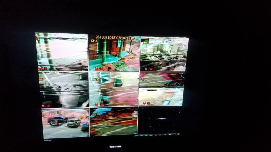

Went to check my cameras and all have static/snow, some with loss of signal that comes and goes. Tried a new DVR box, same thing. Suggestions? Is it as simple as the power supply to the cameras feeding interference but still sending power?
I did order a new power supply to try.
I can see picture in cameras, things seem to be functioning properly, just the "snow" or some kind of interference in signal, but it's consistent over all the cameras so I don't think it's one camera or one cable.
Q-See systems if it helps. QS-458 and QTH-84, both DVR's same issue.thumbnail (64).jpg
Check your connections, when my cameras gets snowy I just move the connections around and it clears them up
Note, just a heads up, it was the camera power supply. New power supply with harness cleared it up, cost about $15.:thumbsups
