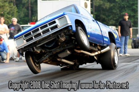

Your stock housing will be fine. Just get your self a cal tracs set up. A local s-10 went Mid 9s with slicks, and cal track and some bs shocks. Its all about how you use it. It can be done, Ive seen it with my own two eyes!

True on the 9sec truck on a 7.5, but I recall 2 Local S-10's that did it ....:gossip:
neither mark or gary had a caltrac set up on there s-10! and jake has a ladder ber set up like gary does now!
mark and gary were running slapper bars aka traction bars !
if i were to set up a s-10 i would go with a cal trac set up with a split mono leaf springs from cal trac!
i just bought a complete set up last year for a 95 s-10 (that i sold to radrod28) and i had a little over 800 in it which included cal-tracs/split mono leafs and rs shocks!
far as using a stock 7.5" i would not it is on barrowed time! some people just get lucky and not have one break!
there is also a guy on s10dragracer.com that builds a bad ass set up called daggers! they are pretty much like a cal trac set up!

This car has cal-tracs
ok so basically cal-trac is the way to go with a split mono leaf.now are those easy to adjust like the pinion angle and what not?.last year i had a mild bult 383 stroker with no bars or nothin in the back and 28x10.5 slick and my 60 foot was 2.90.so this year i got a built to the tilt 403 cubic inch 350 and a trans brake so im gonna need some help.and i wanna spray it.
