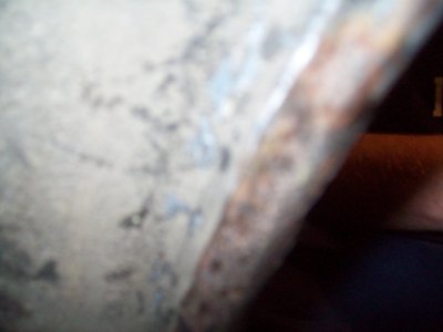

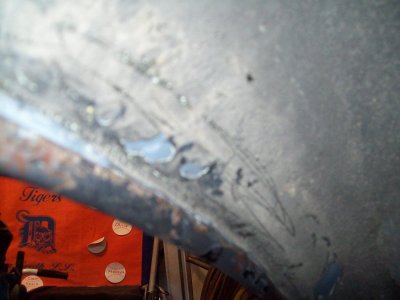

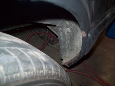

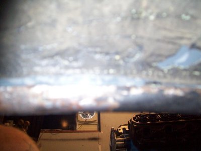

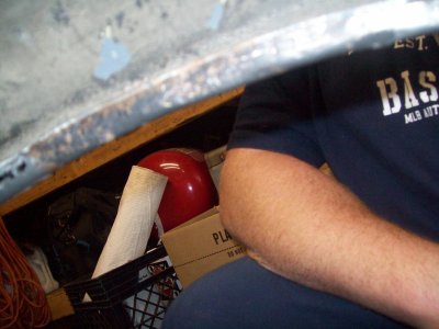

jus go done rolling the lips on the mustang!!!!
jus used a BFH and a brass hammer!!!!
they turned out awesome!!!!!!! no need for expensive tools just a hammer....lol
i will post up some pics a lil later
Do you have any pics? I want to do mine but I am not sure what method....did you heat up the paint an?
no i didnt heat anything up...jus started with the 3lb hammer and kept goin around until it was pretty close and then i used a brass hammer
to finish it off...i will post up some pics tomorrow
