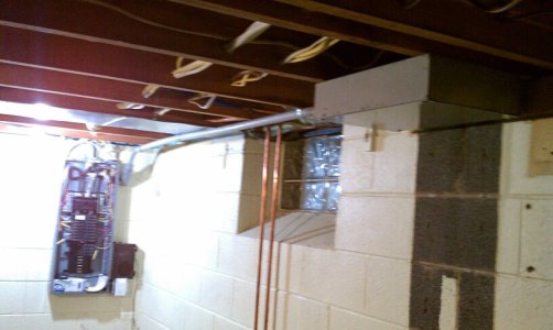

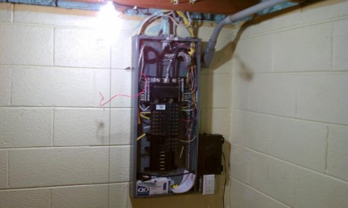

Questions. i need to run a 220 line to a shed for a air compressor...
wikdsvt
What is all needed?
Luckily, my electrical boxes I have 2 and one of them is 1/2 empty, is in the corner of the basement closest to the shed.
Obviously, I need wire, some type of conduit, breakers for the house.
In the shed, do i need another box? I'd like to have 220 to run the compressor and also splice off and have regular 110 to run other tools, lights, and possibly a motion light.
the shed is about 100' from the house.
what will i need? do i need a permit? can anyone do this as a side job?
