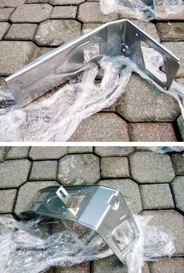

What Is the CCRM module and where does It go ? Will the car run with out It ? Is there a way to bypass It ? Thanks In advance.
It stands for "constant control relay module", basically an all-in-one collection of relays and such. So unless you wire all that's contained inside of it elsewhere, or run a different computer, I'd imagine you can't get rid of it. It's located behind the radiator on this flat steel bracket:
