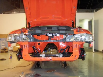

Putting my new k member in my 91 GT today and ran into a issue with the rear most lower control arm bolts not fitting because of the collar on the bolt not clearing the k member. I am using stock lca's. Anyone ever ran into this problem? If so what did you guys do to correct the issue?

Yep ran into that problem, fixed it by throwing it in the trash can, or selling it cheap.
Tried grinding some, I guess I will try some more when I get a chance. If it does not work for me anyone looking for a good deal on a k member? :)

Well I have the bolt issue fixed and now have ran into another snag. I am installing H&R springs and when the bottom of the spring is in, the top of the spring is to the left about 3 inches or so away from the top perch cup. Anyone else run into this problem?

start compressing it and pry it over
