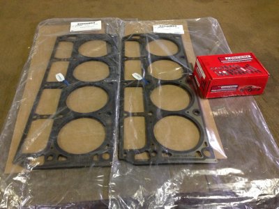

Motor: We recently acquired a junkyard 5.3 LM7 motor with 126K on the clock, complete longblock with accessories. We will be doing very minimal work to this motor the plan is to get some ebay head studs, some LS9 headgaskets, a set of valvesprings, clean it up and beat it to all hell and back.

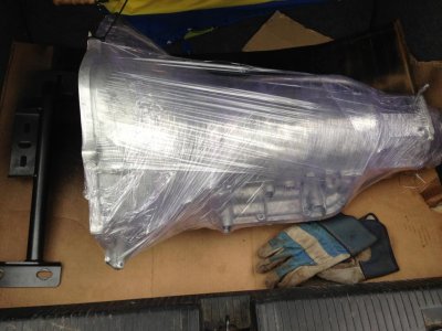

Transmission: Detroit gearbox fresh built TH400 RMVB trans with trans brake.

This is a very basic and generic rundown of the setup we will be putting together, of course anything is subject to change at this point and we will be keeping an eye out for any and all good deals but remember this build will be done on the CHEAP until we can afford otherwise. All parts we have so far have been great deals or thing we had lying around. We hope to learn a lot here as there will be a lot of firsts in this build for Mike and myself. We have no set hp or ET goals at this point just looking to have a running car that we can both enjoy and take it from there. Here are a few pics of what we have so far.
