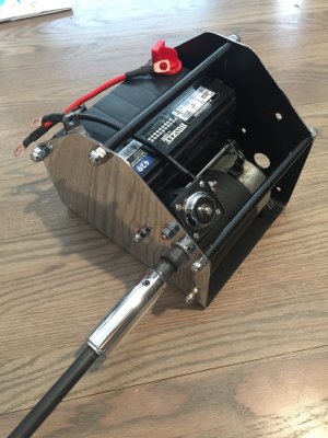

I have a commercial buffer that I use to do all my polish work. Where is the area you need cleaned up? This is an old kart starter I just did for my son. Started out rough looking.

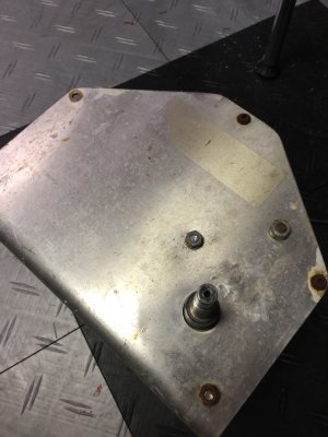

Heres what im working on. I used white rouge on 2 small sections and it seems to remove the foggy haze but it doesnt polish to a smooth finish. it is quite shiny but has scratch lines left in the finish. Am i using the polishing wheel/ rouge incorrectly?

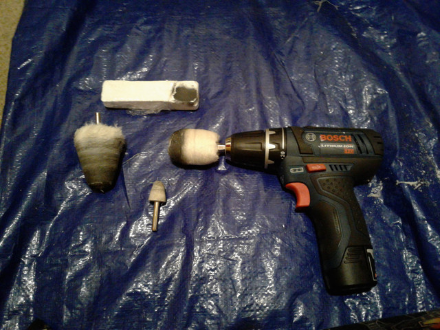

My tooling

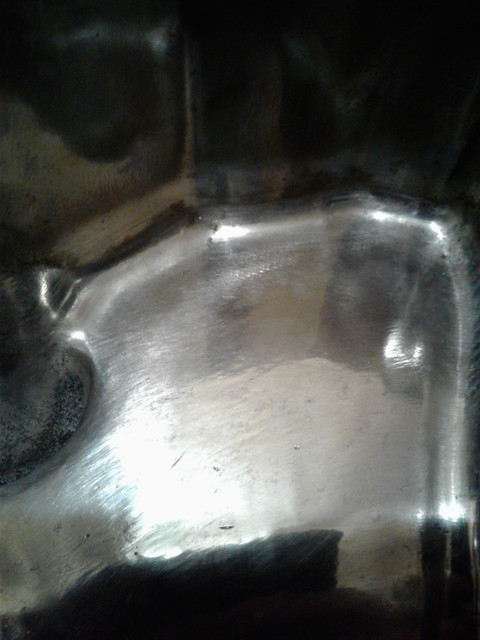

Here is after the white rouge. you can see the slight lines or grooves that showed up after the polishing.
It’s surface preparation. I would 1500 wet sand and then polish it. Those scratches will not go away unless you do.
Is the buffing ball creating these scratches? it was a smooth surface before a ran the ball. it was just foggy. i did apply some pressure but i don't think it was enough to damage the surface of the aluminium with the cloth ball. i'm worried about hitting other spots in fear that it will groove and scratch that surface as well. do i just place the ball on the surface and let the rouge do the work of should i be applying pressure?
