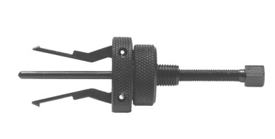

Pilot bushing puller

If he has a cup plug in the end of the crank, you're correct - I'm not sure if his does though. If this is for his '85 5 speed T/A, it should work. I highly doubt that it has a rifle drilled crank.
It's a ZZ4 crank sitting in a 1 piece rms block, by looking at it, I'm guessing using that puller tool it won't hurt it a bit.
