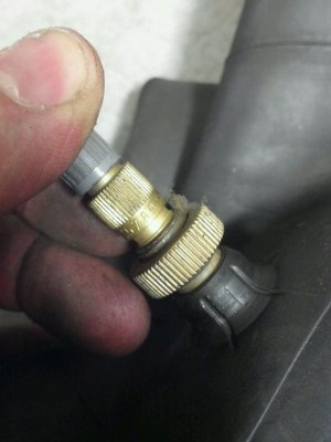

So, i just picked up some used Welds and went ro install my et streets and tubes. The tubes have a brass threaded nut/ collar that i assume goes on the outside of the wheel, but the hole in the wheel is too small. The tube.

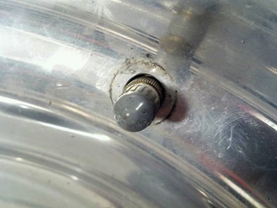

And the eheel.. looks like this wheel has had these collars on there before.
Do i drill the hole out a bit or is that a bad idea?

take the threaded nut off put the tube threw and screw the nut back on tight. mine are like that. then screw the tires to the rim
Thats what i figured and felt dumb for asking. But the holes in the rims are about 0.030" too small to fit the threaded portion through. Seems the hole is about 7/16 (0.437 on my calipers) and the stem on the tube is about 0.475" or so. Looks like my next biggest drill is. 0.486" so it will only take a few seconds to open it up further. I was wondering if i am screwing up the rim if i chose to go back to tubeless and a regular valve stem.
