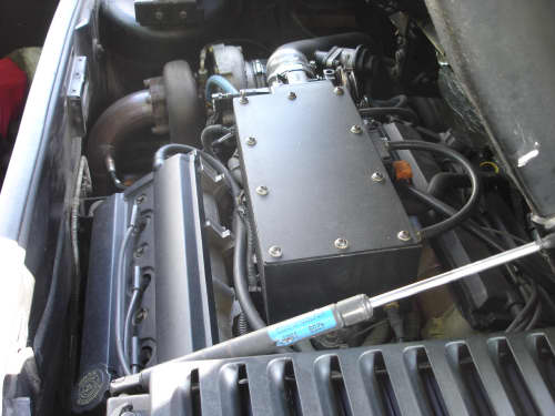

I have a 1987 Pontiac Fiero GT with the following mods.
3.4l DOHC V6 from 1995 Monte Carlo
Ported/polished combustion chambers; good bolts in bottom end; hypereutectic pistons; custom intake manifold; 38 lb/hr injectors; Haltech E6K ECU; custom tubular stainless headers and crossover; GT3071r turbo; Tial 38mm wastegate; Fidenza Al flywheel; Clutchnet six puck sprung hub clutch with stock pressure plate; large Spearco intercooler core with custom end tanks/draw fans mounted under car; I spin the engine to 7k with a 7200 rev limiter.
12" front discs from 2000 F-car; 4-piston fixed calipers; 11.25" rear disc with 2000 F-car rear calipers; front and rear lowered ~3/4"; 17x7 front rims with 235/40; 17x8 rear rims with 255/40.
415 WHP
60ft - 1.90
1/8 - 7.74
1/8 mph - 96.38
1/4 - 11.92
1/4 mph - 118.07
All on street tires with pump gas.
