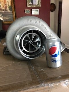

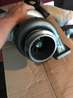

after dropping a sleeve on my Teksid because of procharger and nitrous combo...decided to sell all that off and go procharger. doing a big bore boss motor with 88m turbo...from Forced Inductions...
lots of work ahead but here a few update specs:
3.7 big bore boss block
JE BB pistons 9.5:1
oliver billet rods
eagle billet crank
heads from my old motor (livernois cnc'd and fox lake everything else)
bullet race cams..yadda..yadda..
th400 (which will probably need an upgrade...gotta call Rich)
undecided on converter....
FAST XFI- already installed..but taking out to redo chassis...(no biggie)
redoing engine bay...wire tuck and fender smooth over...

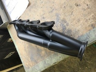

CG fab headers and hot side...
IF I upload a photo...I would...lol

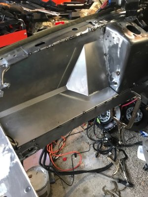

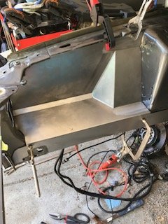

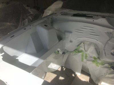

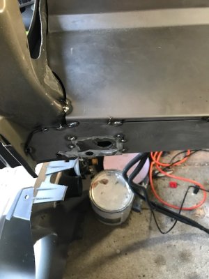

a little more work this past weekend. spot welding panels in. will seam seal everything along with fill and block to baby butt smooth...

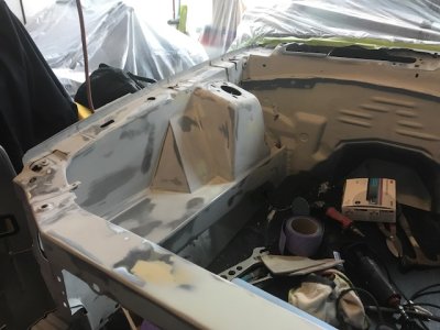

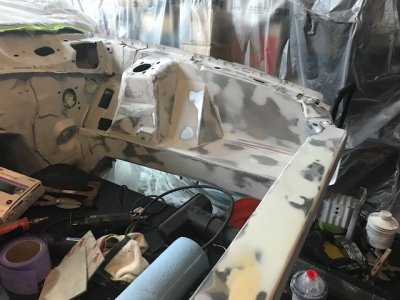

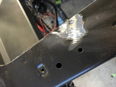

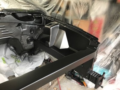

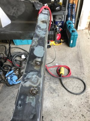

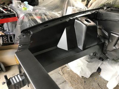

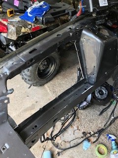

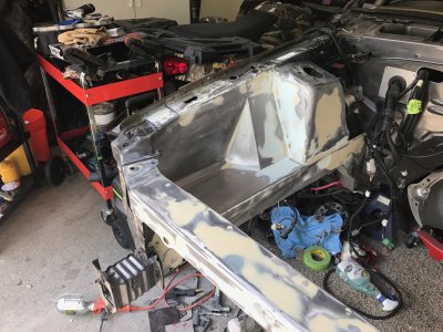

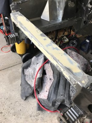

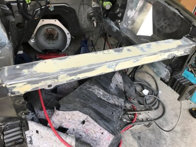

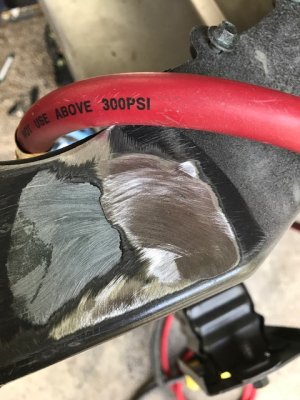

after poly primed...sanded everything for high and low spots...did some more body work and then primed with K2 primer....let dry for a week and started water sanding with block and 400 grit. Will check for imperfections and fix and then prime again next week. I think the next priming "should be the last" before i seal and start laying colorIMG_2995.JPGIMG_2996.JPGIMG_3021.jpgIMG_3023.jpgIMG_3034.jpg

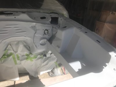

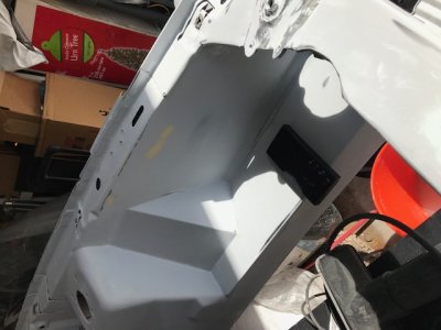

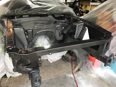

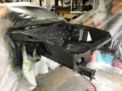

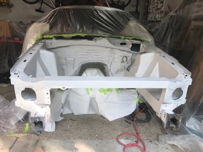

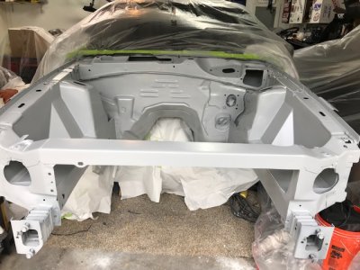

sealed engine bay....since I am using spies...I have a little more time to hit is with clear. I will try to spray the clear next week. So far so good though....
