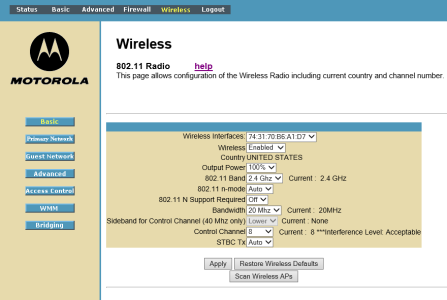

My wireless network is confusing the hell out of me. I have a Motorola SBG6580 wireless/modem all in one thingy-majigger. My internet speed is supposed to be speeds up to 60 mbps. Hard wired I see 55-60 all day long with low ping rates. Wirelessly, standing 5 feet from the device I see 35-40 mbps. First floor anywhere I consistently see 20 - 30. If I go upstairs, my phone, iPad 2 and 3/new/whatever the hell they called them see drastically slower speeds. Ranging from sub 1 MBPS to a max of 5. At night when local utilization is high, it's consistently sub 2 MBPS. Do I need a new router? I can turn the Wireless off of this and will gladly go buy a new one, but don't want to throw money at it and not fix the inconsistency. I wouldn't even care if I was getting 10 - 20 upstairs, but right now it's so slow I can't stream Netflix for Jayden on her TV or play a youtube video on the Xbox if I wanted to.
As a point of reference, this is new. No firmware has changed on the modem (Comcast controls firmware downloads to their modem even if you bought them apparently) and resending the signal hasn't really netted me any changes either. Since wired I see great speeds and first floor sees good speeds wirelessly it makes me think the wireless part of the Motorola device is hoobed.
Do you have any neighbors on the same channel as you? Load up WiFi Analyzer on your phone and see if you do: https://play.google.com/store/apps/details?id=com.farproc.wifi.analyzer&hl=en Another possibility is the strength of the radio in your router. Typically, most consumer grade routers have transmit power of 50 to 100mW. I run OpenWRT on my D-Link DIR-825 and upped the transmit power to 500mW :).
For what it's worth, while the modem-only version (SB6121) is quite good, the modem/router combo version you have tends to get bad reviews with frequent complaints of poor range/slow wireless. Might be better off getting a separate router. I've used the SB6121 a few times with no complaints but have avoided trying out the SBG6580 because of the negative reviews.
5GHz has shorter range than 2.4GHz. Try moving to channel 8 or 12.
The only non overlapping channels are 1, 6 and 11. Using any of the others is pointless. If, you want to stick to the 2.4 band, go to channel 11 as, its the least congested. All though, none of the other networks are strong enough to provide much, if any interference.
Id switch to the 5ghz band if, your devices can support it.
In all honesty, Id turn off the access point in that thing and, wire in a better one. I have put the EnGenius 350 into a few houses with great results (haven't had one complaint) or, you could go up to a more commercial AP that would net you even more range and reliability.

A wif signal occupies five channels in the 2.4 GHz band. Any two channel numbers that differ by five or more, such as 2 and 7, do not overlap. The oft-repeated adage that channels 1, 6, and 11 are the only non-overlapping channels is not accurate. I compiled OpenWRT to enable channels 12 to 14, and run my wifi at 27dBm, or 500mW :). Been running it for 2 years and havent had the FCC at my doorstep yet, although I am on channel 7. Pretty kick ass for a $50 router. The Atheros chipset works well, lightyears ahead of the Broadcom thats in my WRT54GL. As far as I know, you can legally use channels 12 and 13, but not 14, as its reserved for use by the FCC. Most consumer grade routers and wifi cards bought in the US will not be able to use them until the firmware had been modified. You can legally run up to a 1000mW signal...problem is, most routers, youre lucky to get 100mW.
